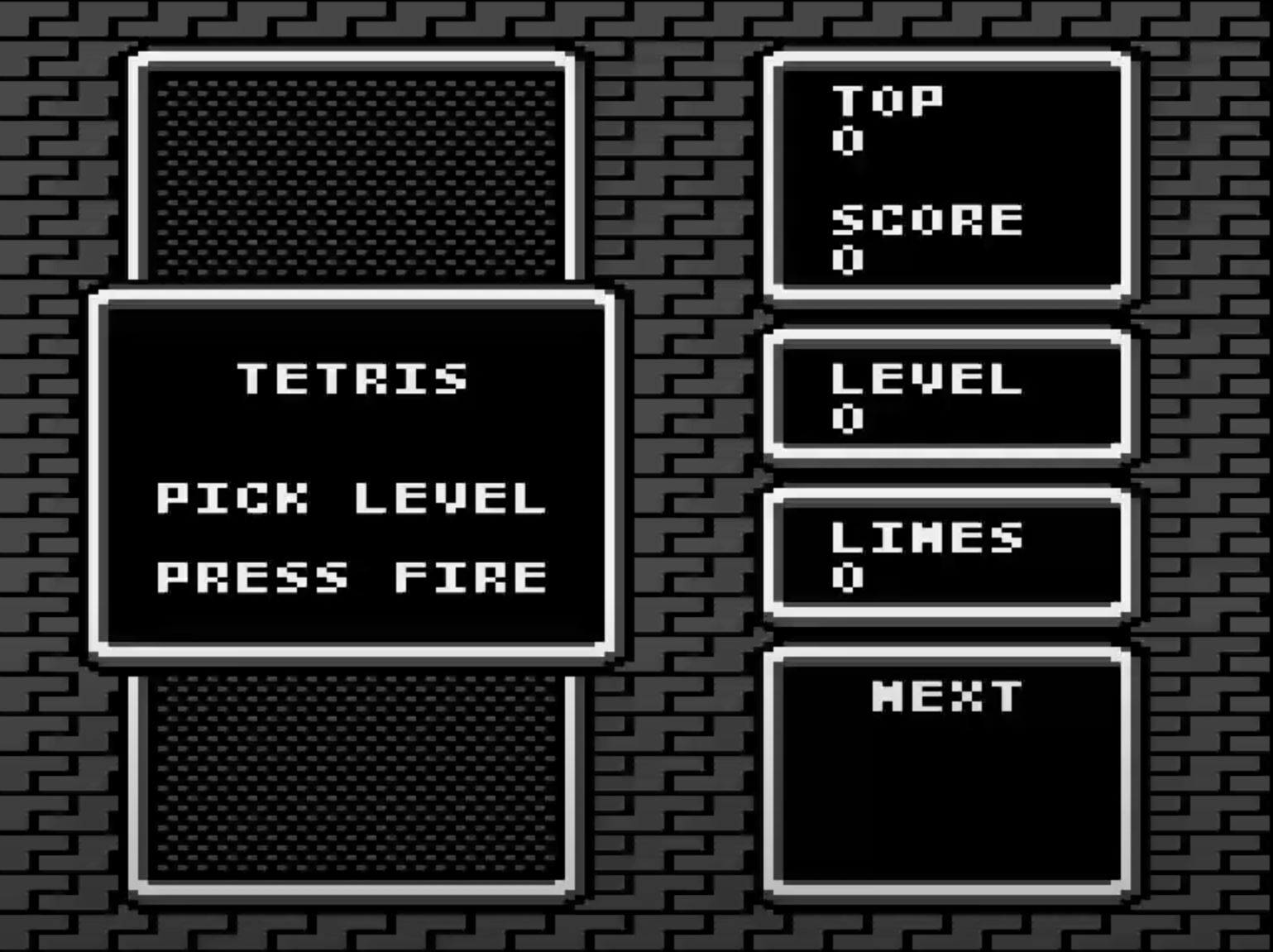

Hier der Beweise, dass es BASIC ist. Leistungsfähige 8-Bit-Hardware (Atari natürlich); neu entwickeltes BASIC, das geradezu zugeschnitten für den Wettbewerb ist; talentierte Programmierer (Eric Carr, Victor Parada) -> die programmieren alle in Grund und Boden im Wettbewerb, nahezu unfair 😀
https://img.itch.zone/aW1hZ2UvMjU4MjA5MC8xNTM3MTMwNi5wbmc=/original/O%2BhzbZ.png
Verständlicher wird's natürlich, wenn man es aufdröselt...

' ===== Outer loop - starts a new game
do
' Prompt Title and wait for key press to continue
' Draw title box
_brush=0:k=13:@O 226,10
' Print labels:TETRIS,PICK LEVEL,PRESS FIRE; POKE 709,4 to reset background color
'@C 1+&""$08$25$71$01$34$25$34$32$29$33$81$0A$84$71$30$29$23$2B$00$2C$25$36$25$2C$0A$C4$71$30$32$25$33$33$00$26$29$32$25$01$C5$02$04$00
@C 1+&""$06$26$71$34$25$34$32$29$33$0A$84$71$30$29$23$2B$00$2C$25$36$25$2C$0A$C4$71$30$32$25$33$33$00$26$29$32$25$01$C5$02$04$00
' Wait a bit before allowing input
pause 30

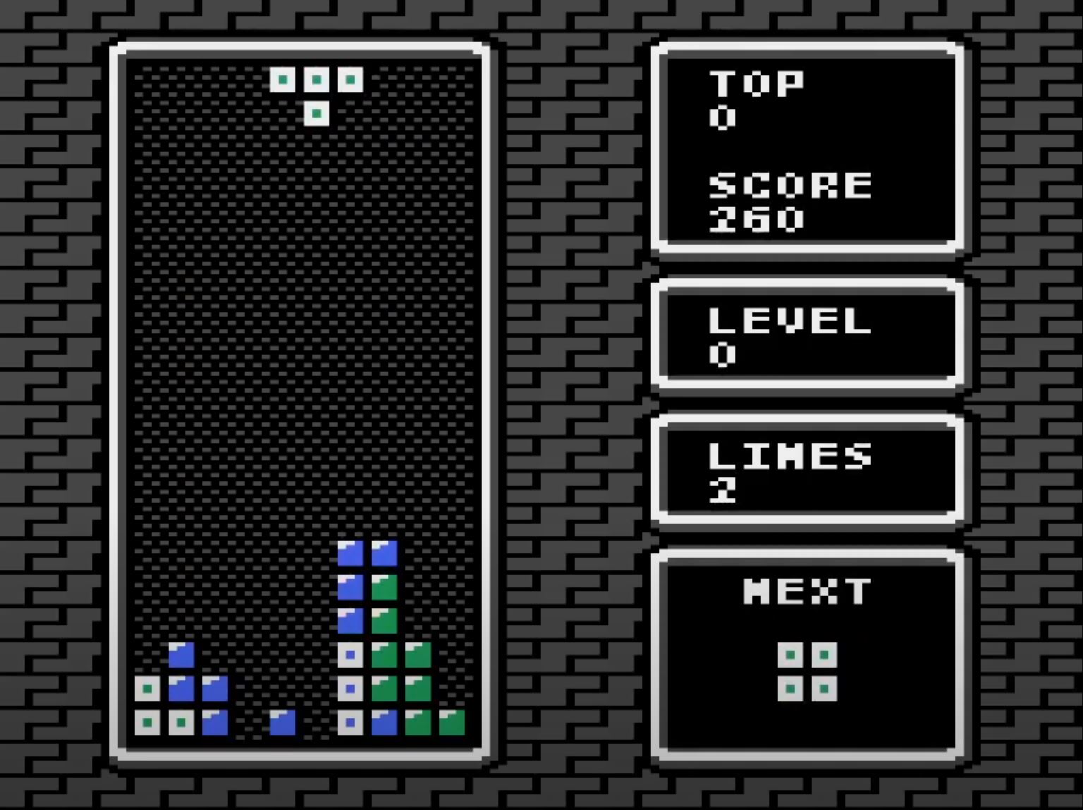

' ============ Main gameplay loop ============
do
' Pause game on key press - covers tetris playfield to stop cheating ;)
' K. is a shortcut for KEY()
if K.
SOUND ' Clear sound
' Backup the screen
-move _scr,_scr+768,768
' Fill in the tetris playfield with the current brush
k=11:@O 35,22
' Consume the pressed key (do this after blanking, since CAPS LOCK triggers a key waiting but does not get K)
GET K
' Wait for another key press
GET K
' Restore the screen
move _scr+768,_scr,768
endif
' Count down until the next frame where the piece auto drops
dec _dropCounter
' Track current piece rotation and position in case we need to restore to it after attempting an invalid move
_rotIndexBak=_rotIndex
_tetPosBak=_tetPos
' Clear intermittent gameplay sounds (moving/rotating piece)
sound 0
' Read Joystick
k=stick 0
' If joystick is not "down", clear "can drop" flag, allowing the player to soft drop when
' they next press down
if k&2
_canDrop=1
_dropScore=0
' Start soft drop if "down" is pressed
elif _canDrop
_dropCounter=0
inc _dropScore
endif

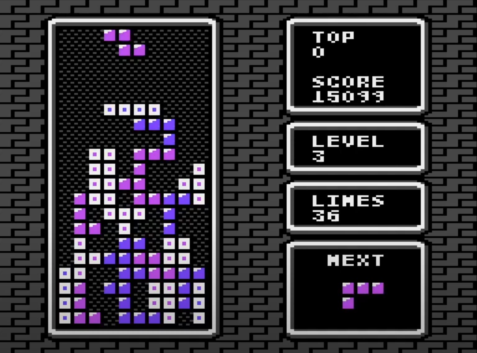

' One or more rows was filled
if k
' Score appropriate based on level and rows filled
_score%=_score%+_data(k+109)*(_level+1)*20
' Animation - Visually clear out the rows from center out, with sound effect!
for h=1 to 5
' Temporarily use _dropCounter to set sound pitch
_dropCounter=70-h*10
' Flash screen on a full tetris (clear 4 lines)
if k=4
poke 709,6-h&1
_dropCounter=23+24*h&1
endif
' Play sound, wait
@S _dropCounter,3
@W
' Play sound at a lower pitch
@S _dropCounter+50*(k<4),5
' Clear a section of each row
@W
for i=1 to k
mset _clearedRow(i)+5-h,h+h,3
next
' Wait, play sound
@W
@S _dropCounter,2
@W
next
